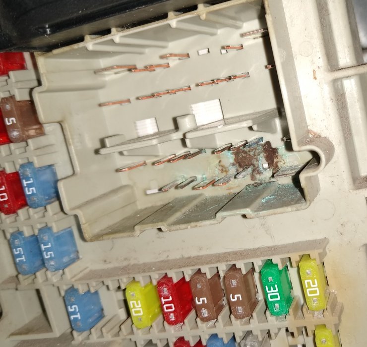

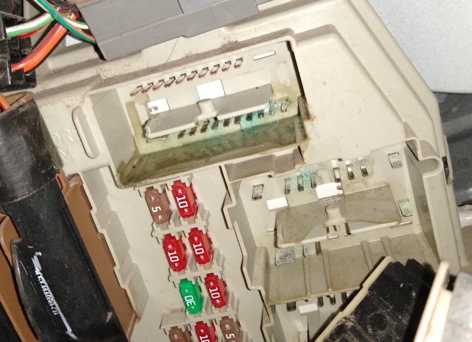

    Some of the 2004+ have problems with a small amount of water getting into the SJB and causing any number of weird issues. This could include individual or combination problems involving lights, wiper/washer, windows, locks, radio or anything else timed or powered through the SJB. The symptoms often crop up the first time after a heavy rain or snow. I'd look very carefully at the entiire SJB area for any signs of moisture.
    06FordFX4
    06FordFX4 Canadian Redneck
    Yeah I didn't see any signs when I was in there. And these symptoms don't happen after snow or rain.

  8. Dustin Maynard
    Dustin Maynard New Member
    Hello, having this problem on an 04 ranger I just purchased this week. Was wondering if the problem ever came back from you or if you found a perminant fix. Tonight I wiggled the wires on the bottom connector in the pictures that were posted earlier in this post and it stoped the problem for now. Plan to take the connector off and clean it good when I get the time. But was just wondering if anyone else had this problem or it ever came back for you. Thank you.
