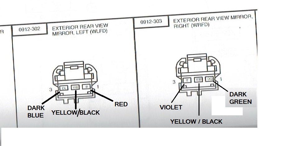

    Here's what the connectors look like in the 2006 model. This was the first year of the larger more angular mirror. mirrors.jpeg

    Yes. Your statement echoes what some are saying on Y**tube.
    The diagram is a plus. Thanks. By appearances, it seems the only difference in the connections is in the wire colors. So its pretty much a plug-and-play deal. Ah, now I am thinking of changing them just for the heck of it.

    I replaced the power mirrors on my 94 with the square mirrors. it required some detective work to figure out what wire did what and I had to swap the mirrors to the old harness of my 94. Don't regret it. I think they look better. I got brand new ones from Rockauto for about $25.00 apiece two years ago.
