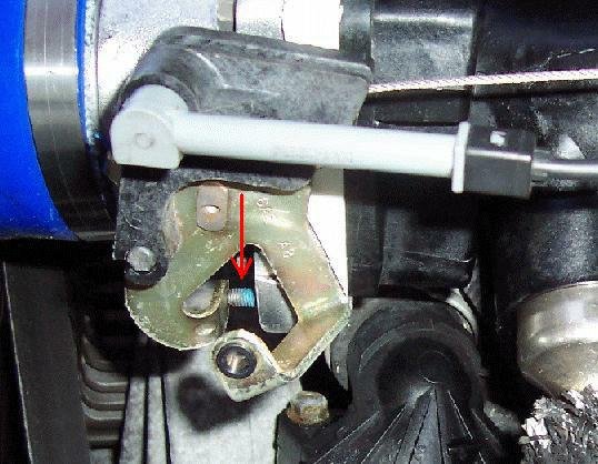

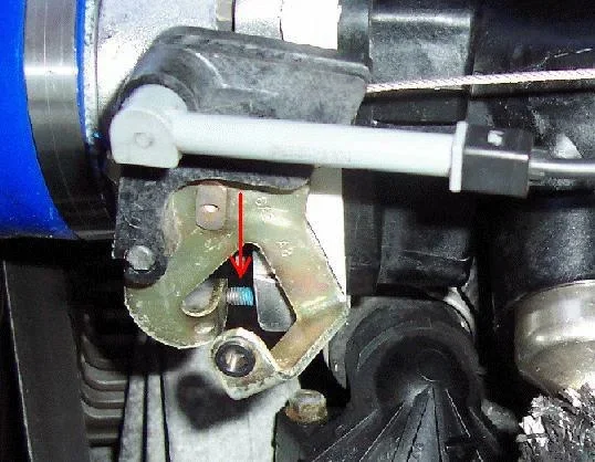

I did a leak down test on # 3 cylinder today and it passed in flying colors. I pulled the plenum again and looked for cracks in the plastic but it looks great. I didn't think it was a valve because it runs great at startup. It is when it idles after warm up I get a misfire.
Well, I finally fixed it. After putting a LOT of money and time I knew it was not a valve after doing a leak down and compression test and it would run perfect until it warmed up and I could drive it a hundred miles with no codes, it was when I stopped at a red light or a stop sign it the check engine light would come on.
I noticed that after warm up it was only idling at 450 to 500 RPM’s and p0303 would come up.
I looked at the throttle body and there was no screw to adjust the idling, mine has a rivet that cannot be adjusted,
The end of the rivet that contacts the stop on the throttle body was worn down and letting it idle too low. I tested it by gluing a dime on the stop on the throttle body that rests against the rivet at idle and it increased the idle up to around 900 RPM’s. I drove it about 200 miles and it ran perfect. I pulled the throttle body and drilled the rivet out and put a screw that I can adjust. I have driven it over 500 miles since I added the adjustment screw and it runs perfect. AAAAA IDLE PLATE.jpg
