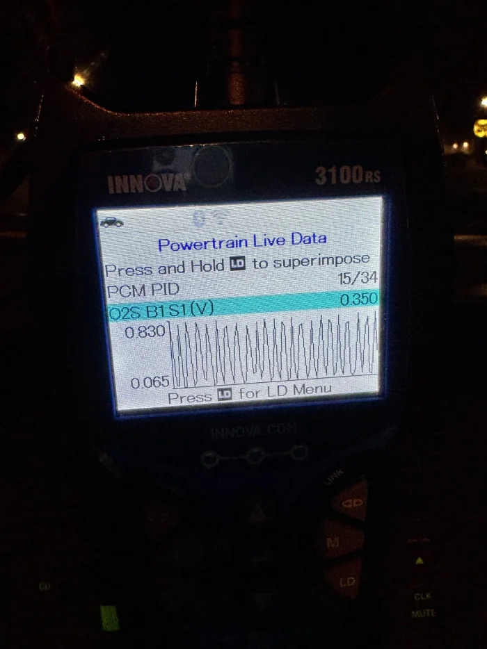

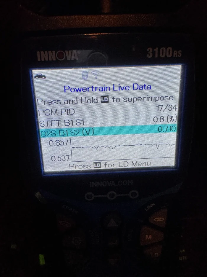

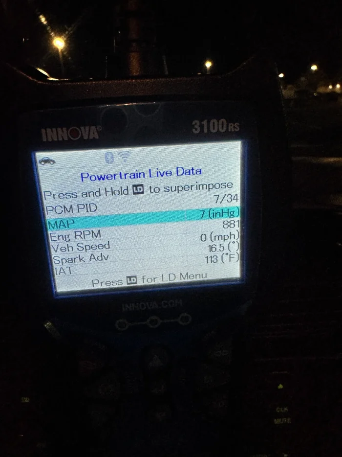

I need help troubleshooting my 2009 Ford Ranger four-cylinder XLT 2 Wheel Dr. my RPMs at idle are 850. And my O2 sensor is going from lean to rich every second I have 113,000 miles and I replaced both upstream and downstream O2 sensors and I replaced the idle air control valve and I cleaned out the mass airflow sensor.
