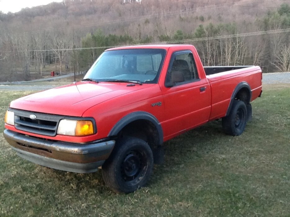

    First I will start off by stating that I have never been mechanically inclined. But I do follow directions very well. I got this little orange beauty a week or so back and she will not move in OD or D. Reverse is ok, I start off in second and then I can column shift her into drive and she will keep going. She will only get up to maybe 2nd gear and then her RPM's go to about 3000 and I can drop into overdrive and she will gear up and the RPM's drop to under 1K. Did I mention that this is an automatic? I don't believe I am supposed to be doing all this shifting, but I dont want to blow a head gasket or anything. REverse no problem, 2nd u can start and then put in drive to go to next gear up and OD for higher gears (haven't hit the actual OD gear yet). I have been looking everywhere for a decent priced/runnning used tranny but no luck. Is there something else I can try to help this transmission isssue until I can get her a new one? Any suggestions would be greatly welcomed!!!!!!! Hardly any rust on frame and body is almost perfect for a 21 year old!
